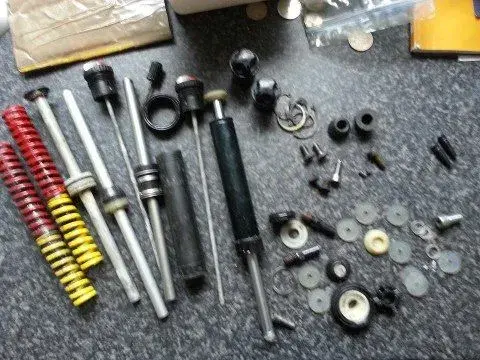

PostPosted: Mon Apr 08, 2013 4:26 pm
retrobike rider
retrobike rider
Joined: Fri Aug 08, 2008 2:36 pm
Posts: 17876
Location: Yorkshire, England
get some pictures up of the internals.
Joined: Wed Mar 14, 2012 5:46 pm
Posts: 259
Location: Newcastle upon tyne
gimmez a minute :D
Posts: 259
gimmez a minute :D
PostPosted: Mon Apr 08, 2013 4:33 pm
Posts: 259
bit blurred but you get the idea :D
