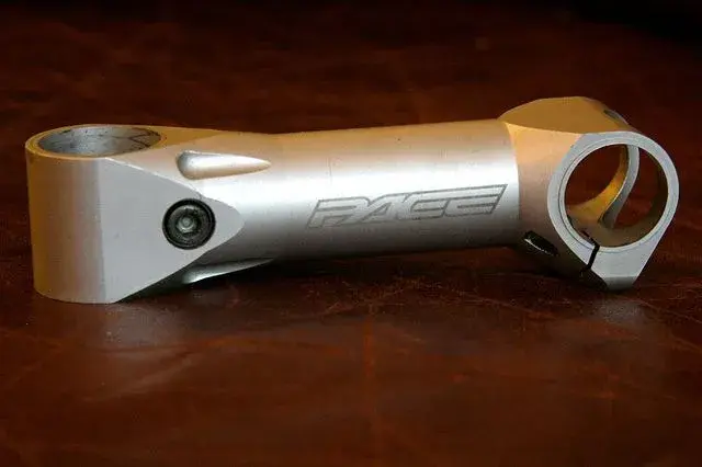

I'd like a Pace RC45 (XC stem) to bolt to it too. However, there are stem clamp marks around the centre bulge of the bar and I'm wondering how wide is the clamp on the RC45 stem? I have old brochures that detail "wide secure clamp area" for the stem but no measurements. The marks are 20mm either side of the dead centre so ideally I'd like the clamp on the RC45 to be at least 40mm wide to hide the 'obscenities'!
Any one have one they can measure before I start looking for one and spending pennies?!
A pic of the stem I'm after courtesy of Google!
...and if the measurements are good, anyone have the stem in silver and 120mm length in very tidy condition?!

You might just get away with it, 40mm external width, 24mm internal

40 wide, 24 internal so the two bits that curl around the bar with the bolts are 8mm each?

Thats right, 8mm at the narrowest point. My stem is a late 100mm job, but I also used to have the early release 120 & 135mm versions, I don't remember them looking any different but I didnt actually measure them. I'll try & post a picture later.

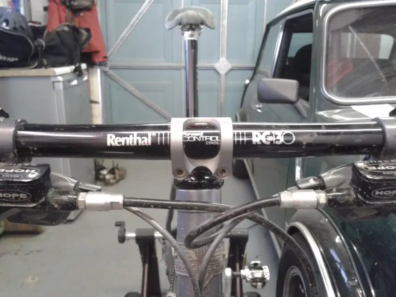

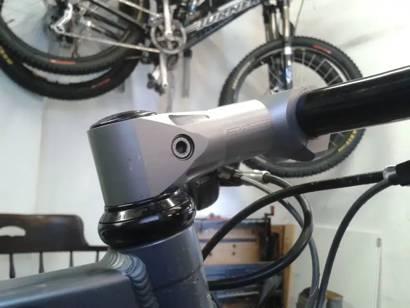

Steerer clamp height is 35mm. The only difference I noticed between the pictured stem (100mm) & my old 120 & 135mm versions is that there is more material in the clamp area immediatly behind the bars - comparemy pic with your google image & you'll see what I mean.

PostPosted: Sun Mar 24, 2013 8:49 pm
Joined: Thu Aug 18, 2011 11:28 pm
Posts: 33
Location: North Yorkshire
Cheers fella!
Looks like Pace had a few failures or scares and beefed up the material
Thanks for the front end shot - I can match up on mine as to whether all the scuffs will be hidden :D
