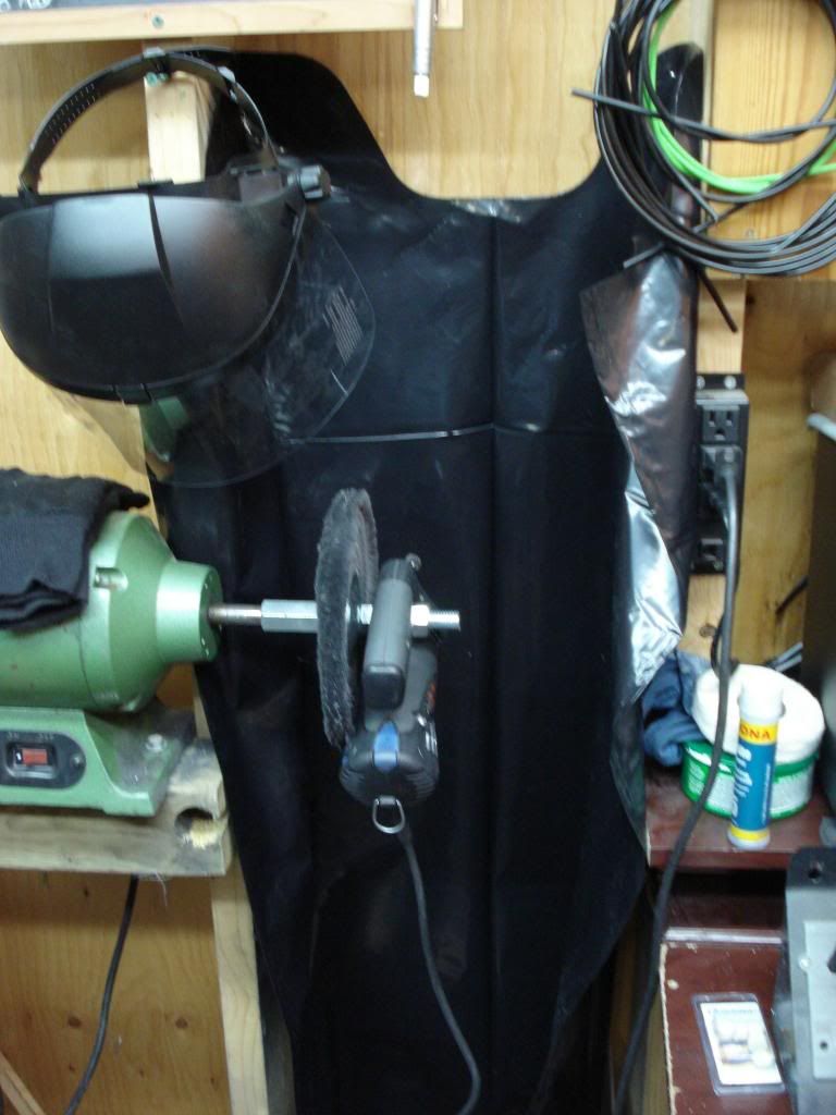

Anything I'm polishing I have professionally acid dipped first. It's cheap and fast.
Here's my 2 main tools;
And some results;
