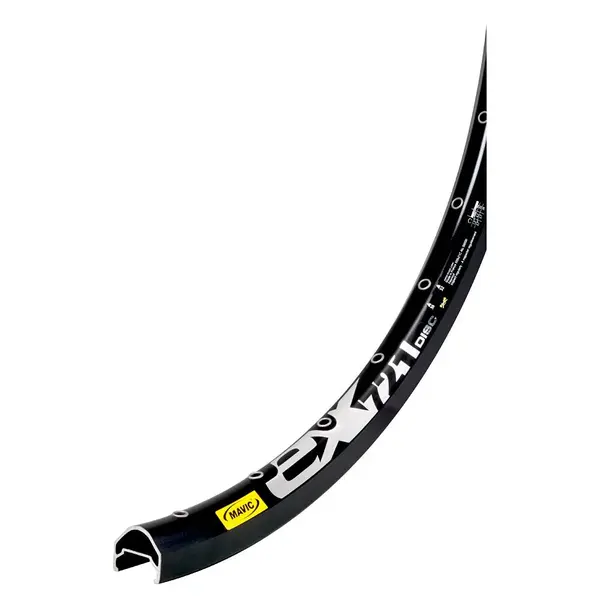

cce wrote:
That rim is an EX721 so pretty burly to start with
I wonder whether they make disc rims differently though? I must say I didn't know you could use an EX721 with rim brakes, but it does have quite deep flat sides and it says UB Control, so obviously you can.
PostPosted: Wed Mar 13, 2013 2:03 pm
retrobike rider / Gold Trader
Joined: Sat Jul 21, 2007 9:48 am
Posts: 7605
Location: Bristol
EX721 was intended as a rim-brake capable burly rim. I think it's basically a D521 replacement
PostPosted: Wed Mar 13, 2013 4:00 pm
retrobike rider
retrobike rider
Joined: Sun Sep 23, 2007 11:22 pm
Posts: 7321
Location: Hove
Yes, I had just assumed it was disc-only because most of the rims called Disc are disc-only. Is it just my old eyes, or do the walls look slightly thinner above the cross-brace than below it, even in this latest version? I'm not sure it's a good idea - if a rim is supposed to be burly, I'd like the bits I can't see to be as burly as the bits I can.
