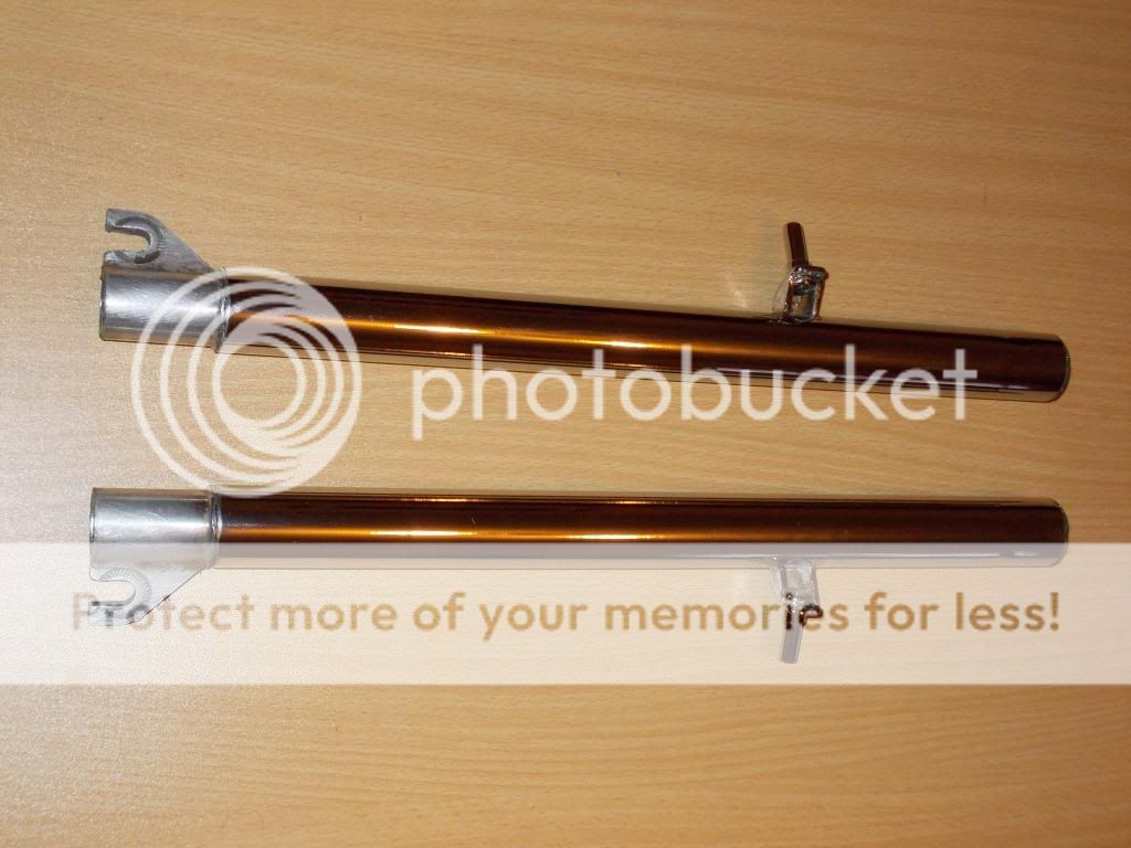

PostPosted: Fri Mar 01, 2013 9:31 pm
Joined: Tue Dec 04, 2012 6:15 pm
Posts: 554
Before:
After
NB, they don't look so brown in real life, I'll try and get some better pictures later
PostPosted: Fri Mar 01, 2013 10:38 pm
Joined: Mon Jun 14, 2010 9:06 pm
Posts: 4861
Location: Herts UK
brown can be nice too.
