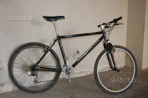

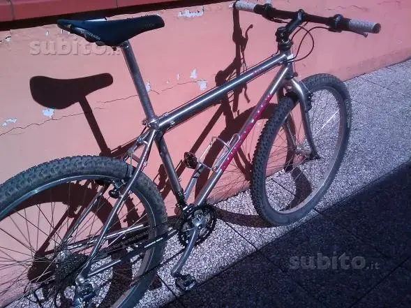

I said I had a dbr axis and I loved it, now I'am looking for a new old bike, and I need your help to decide what to choose.
I find the of the pics i attach:
the first is an apex tt lite,
the second I think is a dbr wcf6.0
and the third is a wcf vertex.
I like very much all, the carbon charm is hard to resist, also the titanium finish is very cool.
But I don't know if it is dangerous to buy an old bike made of composit material, maybe it made older than the steel?
What should I verify to buy it, consider that I cannot view the bike but in photo, do you advise a beginner to buy an old bike made of carbon?
I don't know if You had chance to see one in person,
It's more like, fine brushed steel (True Temper TT Lite) tubing with clear lacquer. Very nice, light frame.

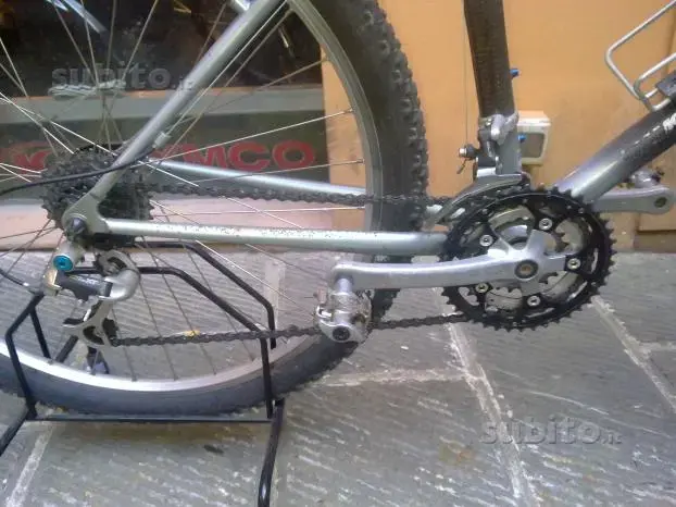

The WCF has some point of rust on the little tube near the chain, you can see it in this photo, I don't think it is a big problem, but I don't think is easy to paint the bike as it is partially not painted ... correct?
I wouldn't worry about that at all. Someone has removed the chainstay protector at some point, probably because it was chewed up. Easy enough to touch in the chips and put another over that area.
Great bike, seriously nice ride.
The frames of a given year were the same throughout the range.
The second one indeed is a 96 6.0.
I would be happy with any of those bikes to be honest.
