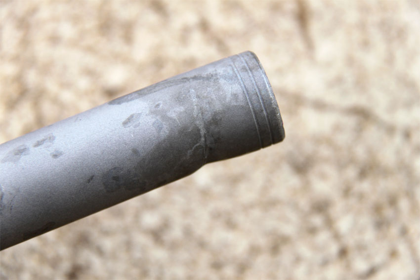

The MC1 needed also some love before getting new colour. Someone clamped the barends a bit to hard and the result are 2 dents in the MC1.
To reshape the MC1 I used a soft wood stick. It`s better than using a steel bar or something else because if the stick is to hard you can easy ruin the MC1. I hammered it a bit in and so the dents came out a bit.
The result is a not new but better shaped MC1.
