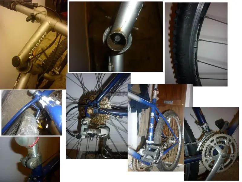

the speed kings ? sure lets do it. one is a bit worn .. the best one can be in seen in the photos below. I'll work out a way to send photos to you.

ok ..
thanks for the replies. I have taken some photos to help illustrate .....
I want to change the wheels firstly because i had a boardman comp with richly wheels and it glided along so smooth it was such a joy. The front wheel of this one hardly turned and made a terrible clunking noise. Its a lot better with the carrera wheel as seen in the photo.
The wheels that came on it are like the back one in the photos. I am told they are not the originals.
The stem.. well its a bit wrong. The previous owner said he took out the bolt (?) from the middle and replaced it as it was all seized up. The bolt in there now can only be undone with some kind of extended spanner. There is nothing to hold the 'cap' on top and the 'cap' doesn't really fit.
so what else..
the 'collar' that hold the stem to the bike looks a bit shit and i think i fancy some cooler pedals.
I have had a go with some t-cut and metal polish and am confident of getting the paint job looking better. I respray would be an expense too far but is there any way to get the rust off the frame ?
I asked the guy in halfords when i went to buy some cleaning stuff but he told me steel frame mountain bikes didnt exist and in the old days the used titanium! anyone know any good cleaning products for titanium ???
ok .... lets figure out how to get these photos up here.....

In terms of your stem.... it would look a bit like this (if you removed it)
So basically.... as you do the bolt up, it pulls up the wedge shaped bit and jams it in to the forks. So guessing that the old bolt was knacered and he put something else in it's place. If that's the case the the top cap isn't doing a lot more than keeping muck out.
By the way - what exactley do you mean by, 'the collar that holds the stem on to the bike'? The big round bit at the top of the head tube (that's the tube at the front that the forks go through)? If so that's probably the top of the headset.
To be honest - I might be tempted to buy some tools (if you haven't got any) and strip the lot down to a frame and put it back together again. Really not that difficult and will give you a good idea of what you're dealing with and also is a good way to check that nothing cracked or broken.
To be fair, looks like a nice enough bike. Certainly worth putting some effort in to. :)
