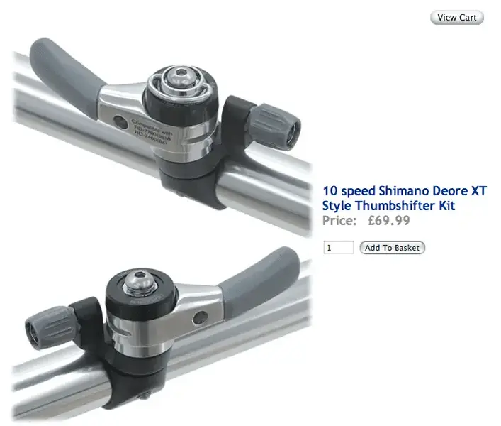

Oh course, you can always go to " the dark side " with the SJS 10 speed indexed thumbies.

Tell me more....10 speed thumbies....?

I, too, run 7/8 speed XT thumbies with 8 speed cassettes, no probs.
But I must say, those SJS ones are pretty intriguing. Bah - 9 and 10 speed cassettes prolly just wear out more quickly anyway.
(and cheers for the link, Mr Scum.)

Weird set up on SJS but here's a screen shot....
