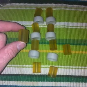

Ok I've stripped down my pace rc35s. I was going to fit what I thought was the correct elastomer set but these are too small internal diameter to go over the long bolts that fit on the bottom of the fork legs.
So it looks like I have the wrong elastomer kit.
Question is, how can I *not* pay £40 plus £8 grease from the pace shop? Sorry but that is a massive rip off for some bits of elastomer tube and grease.
Is there an alternative? Does anyone want to swap my kit for the correct one?

Why not just run a drill through the elastomers to open up the hole so the bolt fits?

Was going to but they're also smaller od so by the time I've drilled them out there won't be very much 'meat' left if you know what I mean...

You appear to have the elastomers for the rc35mxcd's which are smaller than standard rc35 elastomers. Mxcd's use 16 in total iirc, definitely try tim at fork English as he knows his stuff and is very helpful. There is another place online that sells the elastomers but they charge the same as pace.

I'm just about to try out some elastomers from Thudbuster seatpost to see if they'll fit (or can be made to fit)... otherwise it'll be a case of buying the damn Pace ones.
