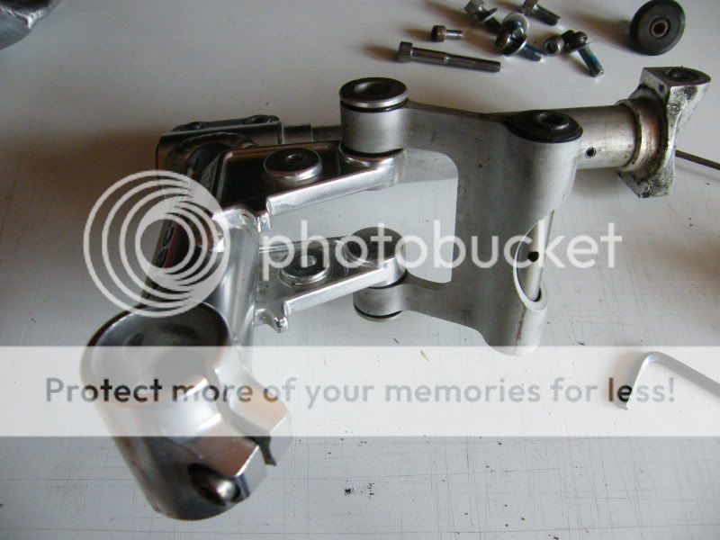

I have just got a pair of Vector 2 forks from ebay. They were the silver ones that were not quite right if anyone was watching.
Got the damper unit sorted, that was not too much of a puzzle, but I have noticed that two of the 'top hat' pivot bushes appear to have the silicone washers on the inside missing.
As all these washers seem to do is keep mud, dust and other high speed detritus from the bearings, I can easily replace them with O rings, but a close up photo of the pivots or just confirmation that there should be washers on the inside of all four top hats would be useful.

You mean the black 'washers' you can see in this pic? They would be necessary to stop metal on metal wear, and take up a little play. Not sure O-rings would be suitable as these washers are quite hard.
The V2 is slightly different, but what I am talking about are the washers that in this picture are between the narrow end of the top hat bush and the stem.
I appear to have one missing from the top and one from the bottom, but I have just ordered a couple of the kits that D-C suggested, as there appear to be a number of the washers / O rings fitted to most of the linkages.
