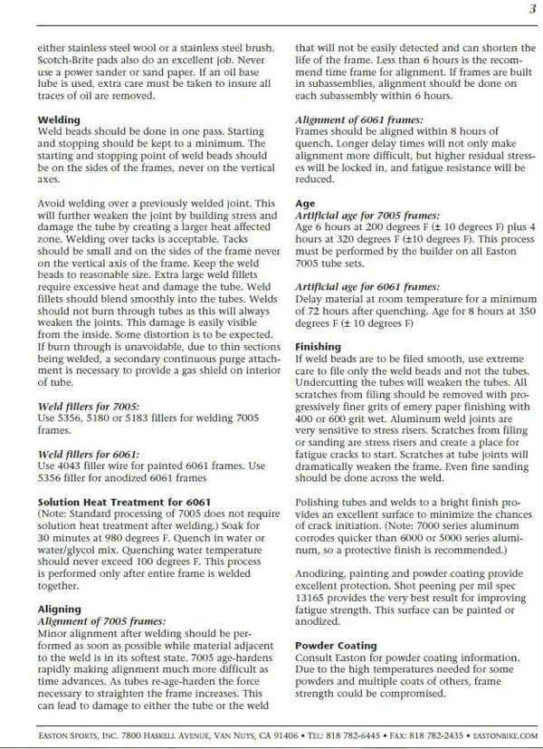

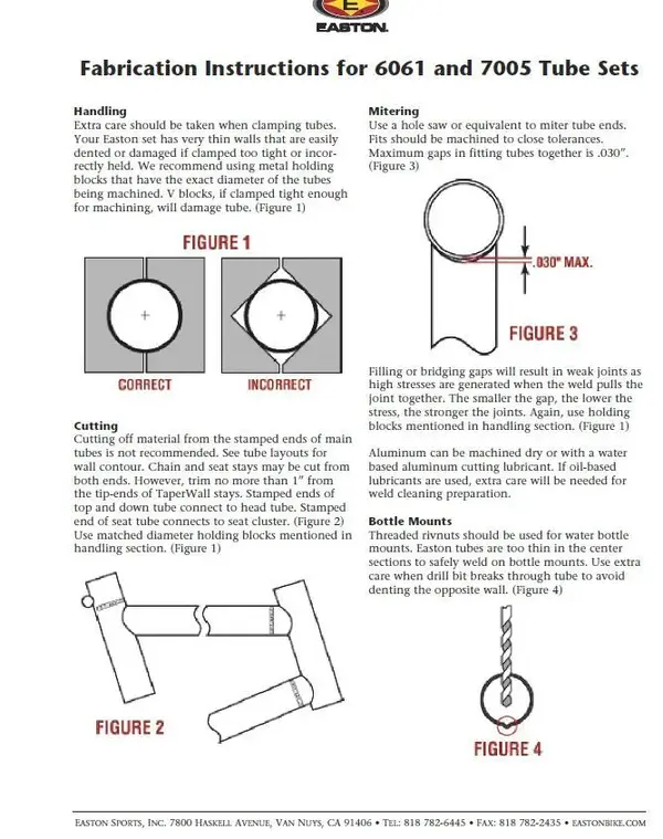

6000 series aluminum is more challenging due to the heat treating. 7000 series requires much less heat treating. Below is some fun reading a frame repairer sent to me. Heat treating is on page 3.
Thunderchild
