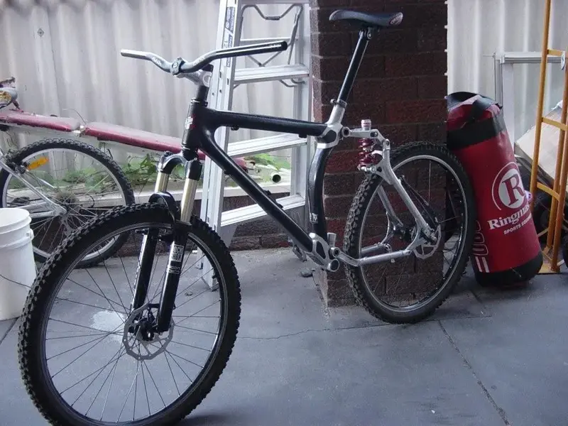

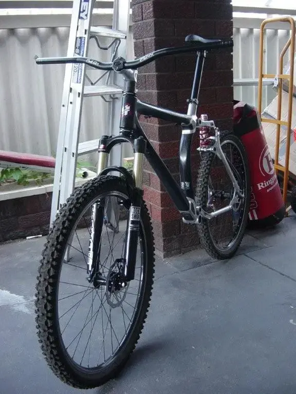

Feeling a bit more positive today. The bike fits me ok (frame is a little smaller than ideal), and is starting to look pretty cool. :)
Should have it built up in a week or so, but it will probably take me a month or so to get the suspension rideable.

Hang in there bro, looking good so far!
Just take it easy with the drill though! It is easy to get frustrated and bugger something up when a 2 week wait for the right part to be posted surface from inner mongolia would be the best option. Look forward to seeing the whole bike finished and being used though. :D
