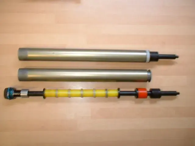

the blue (mani 3) top cap/adjuster will unscrew from the stantion , then pull it out and you have your elastomer stack
the picture is of the manitou rear sus , but it is basically the same principle , the whole thing unscrews

Ahhh cool - this works on the Comps and I've managed to get them undone... just need to remove the wooden packer that their previous owner replaced the elastomers with :?
Tried the same on the threes and it's just VERY tight, think I'll need to employ some cunning but gentle vicing technique
Thanks for the rapid response :)
