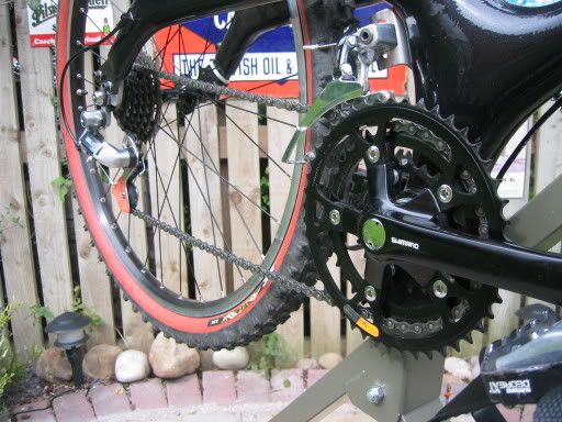

Would this do the trick?
http://cgi.ebay.co.uk/SHIMANO-DEORE-XT- ... dZViewItem
PostPosted: Fri Oct 12, 2007 2:24 pm
Joined: Wed Oct 05, 2005 7:45 pm
Posts: 11018
Location: kent
I think so , but i would wait for a second opinion before paying for it . :lol:

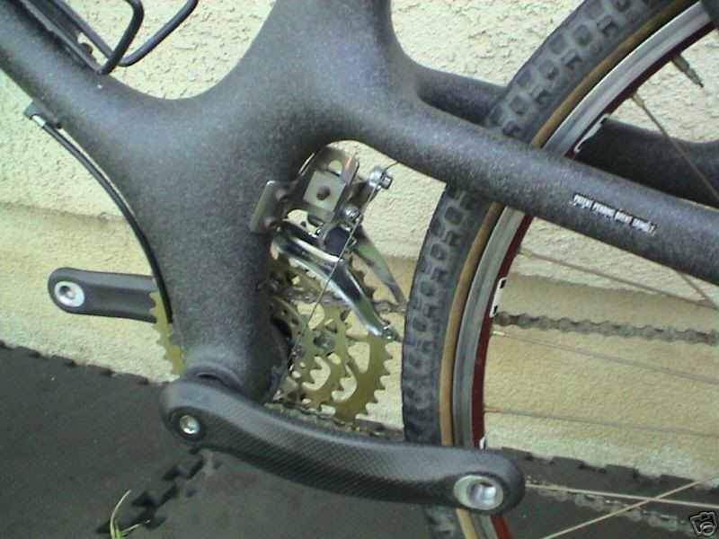

You need an endless clamp version like on my kestrels, they normally come with a band that slots the back where the allen head is but you dispose of that and use a 'shaped' bolt that fits snug an the bach of the plate.
