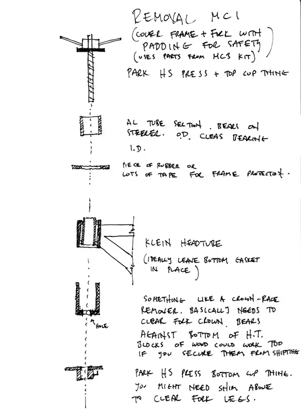

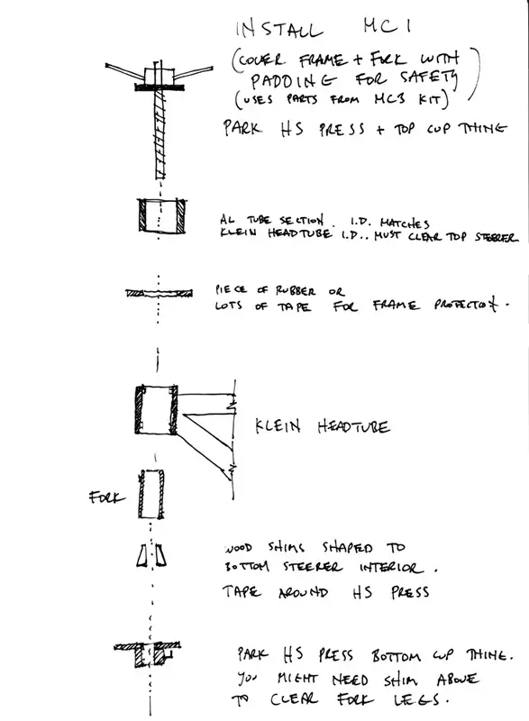

i have a Klein headset hack which has worked (i think carsten thought it was ok).
it uses a park headset press (internal, less likely to scratch paint) for both removal and install as well as various tubes, shims and cups, many from the MC3 toolkit (readily available).
The only custom parts i made were wood shims for the underside of the fork steerer to replace the metal ones in the original kit.
For removal, i preferred a threaded option versus hammering, so i used something akin to a crown race removal tool to place on the underside of the headtube and clears the underside of the fork.
i wish had pics ...
PostPosted: Sun Sep 09, 2007 12:43 am
Joined: Mon Oct 02, 2006 3:13 am
Posts: 257
Also, the small tubes from the MC3 kit are what shim the headset press from the frame. using dense rubber between tool and headtube also help to eliminate frame damage.

Thanks for pictures of the tool !
If I need to change my klein BB, I now how to do !

 Post subject: (bad) sketches
PostPosted: Mon Sep 10, 2007 1:35 am
Posts: 257
here are some sketches.
it still uses lots of concepts from the MC1-2 instructions, it just uses inside of steerer.
when i refer to MC3 kit, its the one you commonly find in the canvas roll-up.
i have used this successfully on a MC1 (93 Klein Attitude) removal/install.

sorry, forgot to add that i didn;t need to install new bearings.
um.
bearing removal could still be done using these instructions.
bearing install is simpler.
