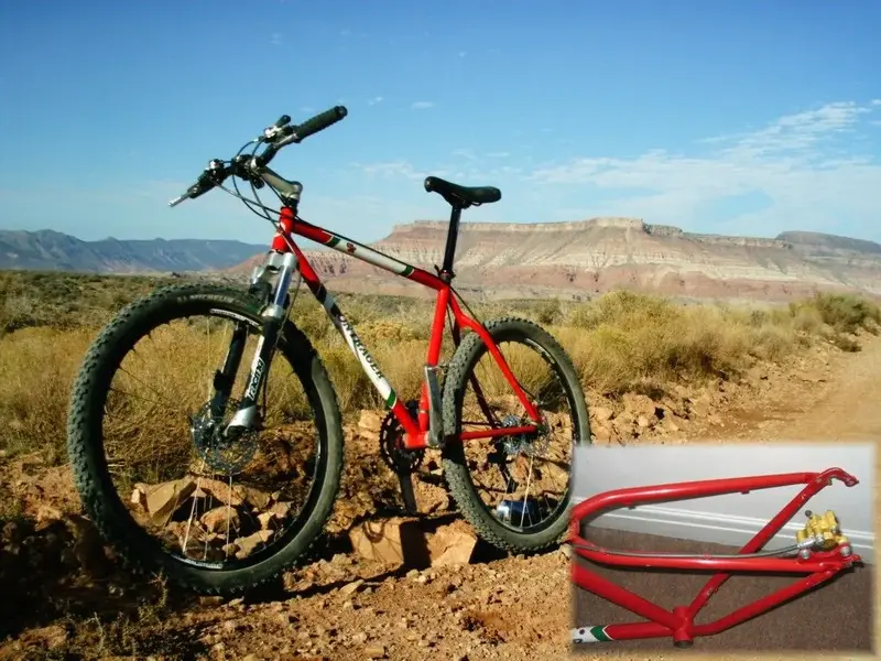

This did me proud for a good few years and is still going strong, no problems with then disc mount, work was done by Paul Donohue in Bishop Auckland, sadly, he is no longer building frames
Oh yes, stickers by me :)

Yes still going as its now mine 8)

You're making me jealous now Gil... nice build, I always wanted a Bonty. :cry:
