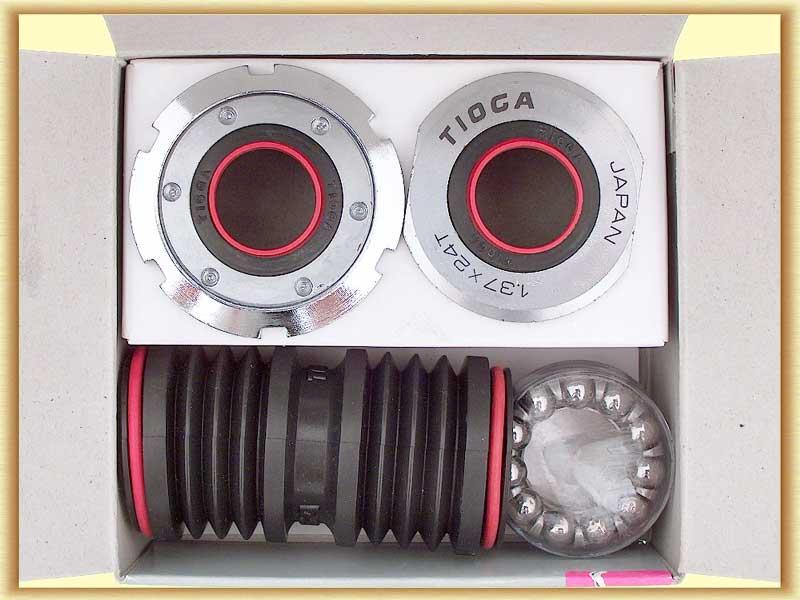

Mount the balls without the ring! 11 1/4 balls will fit into a Bottom Bracket.
In another thread I read you need rubber thingies. Ernie sells complete cup assemblies => http://www.bikeboosting.nl/index.php?id=162,0,0,1,0,0
Scroll down

Do you mean I don't need the rubber gaiters for my BB? Don't they keep the crud from getting in?
PostPosted: Tue Aug 14, 2007 5:27 pm
Concours Judge
Concours Judge
Posts: 8259
Location: a proper EU country
'Gaiters': For the good understanding (I am non native English speaking) with Gaiters you mean the seals that fit round the axle in the cups to prevent dirt from outside coming in???
If so, yes you should mount them.
What you shouldn't mount is the steel ring in which the balls normally fit. Mount the balls without the stupid steel ring. They move freely now. Waaay better!
