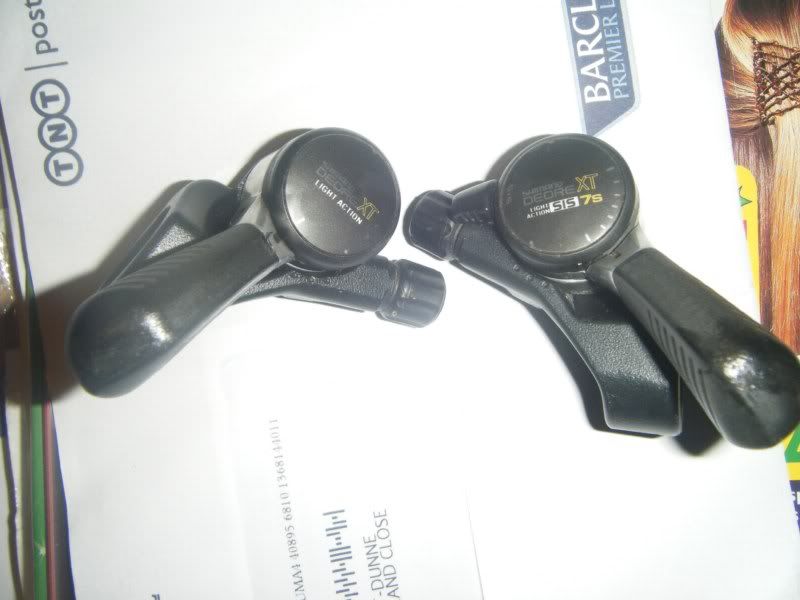

That top decal thing is just a sheet of clear plastic, lift it off your thumbies will look like new beneath
Water gets under there after 20 years:-)

Here's a pic:
Of course it is possible yours are gouged or whatever
But in the first instance get that clear layer off and see what you get

The other thing is, that top plate, is just a disc of dished aluminium glued onto the plastic top cap, so it can be lifted, as I had to do due to a dent, and then panned back into a dish, well pushed with thumb, it is very soft material. I then glued it back on with waterproof contact adhesive.
But yes stickers to replace the existing decal on that alumium plate might be an aesthetic idea for some.
Oh, and the plastic discs that were on top of the decal plate on mine were long gone, but how old are these things twenty years plus in all elements, my, they have done well.
