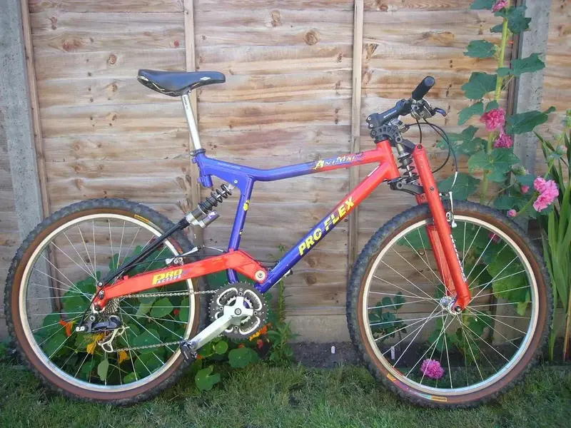

I have been riding my Proflex (see attachment) for about two weeks now and it has exceeded expectations: it handles really well downhill but is light enough to pedal easily uphill with no bobbing. My build is not completely retro but it is enough for me to see why people like these bikes and at about £130 total for the frames and forks I can't complain.
One problem I have not yet solved is how to attach a front mech: I bought a conventional Shimano LX bottom pull but find there is not enough room for it to fit on the seat tube between the BB and swing arm. Do I need an e-type mounted front mech? Any tips from you Proflex gurus would be much appreciated.

Good job - well done.
My 857 which has similar set up but with carbon swingarm uses a standard top swing front mech.

Thanks for the tip, clearly I need a topswing mech. Nice work with the paint stripper by the way!
