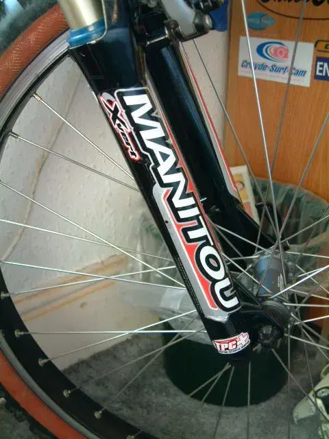

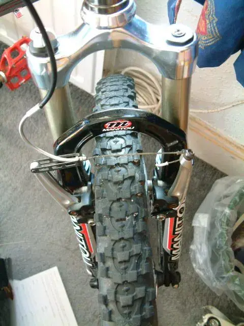

Hi Jamie,
with any luck this should post some pictures to show you the forks and the adjuster that broke off... i'd be interested to know of anything else you have for these forks as well, seals, springs spares etc
kind regards,
fritz
on an x-vert rebuilding mission.
File comment: the offending article!
File comment: Top down view - note missing adjuster
File comment: X-Vert with tpc & microlube

Hi Fritz,
I have one of those pesky adjusters, only it hasn't got the 'TPC' badge on it.
Now just a thought, do you still have the one that broke off?? If you have then were you aware that it is only held on by a liitle screw. so if you prize off the badge it will reveal the screw head. You can then replace the screw, refit the adjuster and then stick the badge back on.
If you havn't got the part then you can have this adjuster for ...... well.....mmmmmm.... for free!! or a packet of biscuits!!
As for the other parts well i have a load of spare parts for Manitou xvert carbons, now there must be some parts that are the same as your forks so if you let me know what you are after then i will have a look for you.
Cheers,
Jamie
