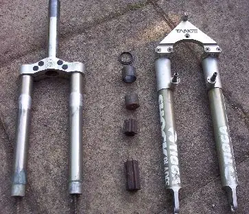

PostPosted: Mon Jul 30, 2007 7:30 pm
Joined: Thu Jul 19, 2007 7:18 pm
Posts: 3798
Location: Staffordshire
Baretto's (sorry about the spelling) altered these and did a good job as I never had any trouble riding them apart from seals designed to cope with a Californian summer and not a Dartmoor winter! I never saw them in their original state but assume that the smaller piece of elastomer is extra. This piece is 28mm long and the bolt is 130mm. These are apart for the first time in ten years and it's amazing how you remember how they go. I even remembered to use a spoke to get at the lower seal! Iused to have to do it at least a couple of times a month. Happy days!?

 Post subject: Long Allen Key
PostPosted: Mon Jul 30, 2007 10:58 pm
Posts: 3798
Sounds right. I have a very long allen key in the tool kit which I haven't had to use for years. The bolts in the picture are long threaded rods with two 10mm nuts tightened against each other. I have a very ordinary socket set and the long extension bar c/w 10mm socket are a perfect length to undo the bolts.
