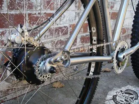

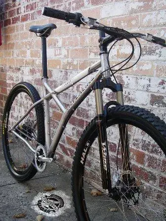

Not a 2x9 but still worthy of some drooling over........
