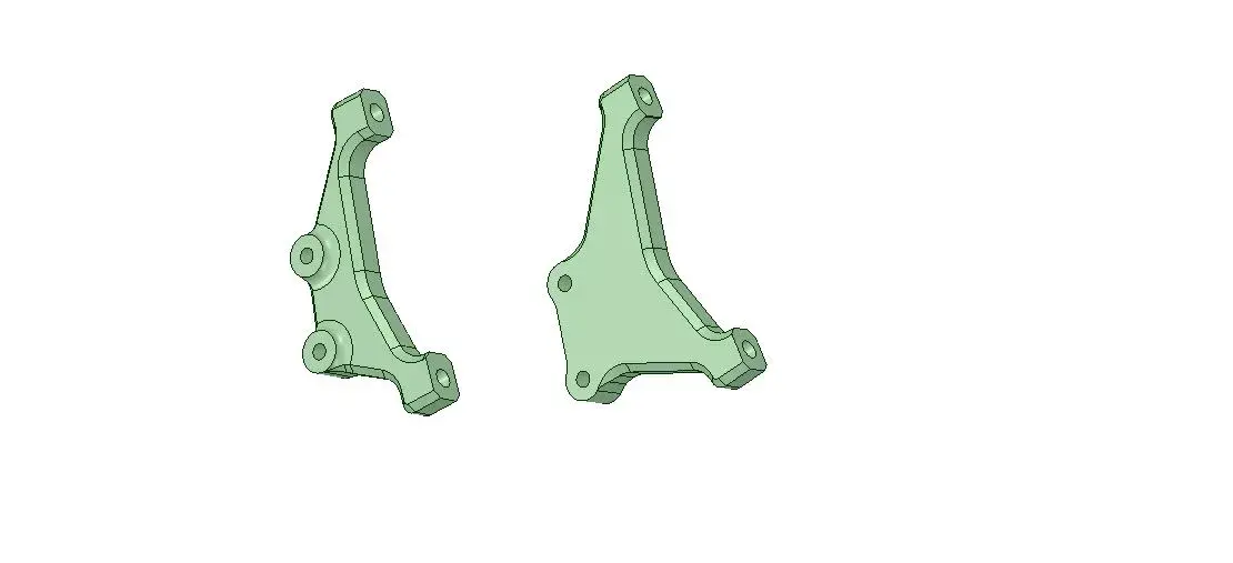

I've had a look at the front first, the post mount can be done in 10mm aluminum, the ISO will need to be in 4mm stainless, due to distances between mount and disc and being able to use ISO hubs.
Thoughts please......

ishaw wrote:
I've got a rear mount which I can measure up if you like?
Ian
Is this giving you IS compatibility? Would be really interested in how you go about making one of these, IS or Post. Anybody got dimensions or a tech drawing?
PostPosted: Mon Jul 12, 2010 7:45 pm
Joined: Fri Jan 05, 2007 12:14 am
Posts: 1322
Location: Sunny? Devon
Gadro wrote:
Ian
The two drawings I've shown above give you the option of using 160mm ISO mount discs and either post mount calipers or ISO mount calipers on the front. If +20 was required then this could also be done. Rear post mount will allow a 160mm disc on ISO hub to be used.
Easiest way would be water jet cutting, then secondary ops for threads.
ATB
John
