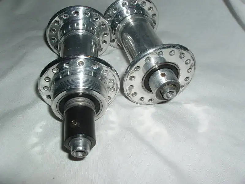

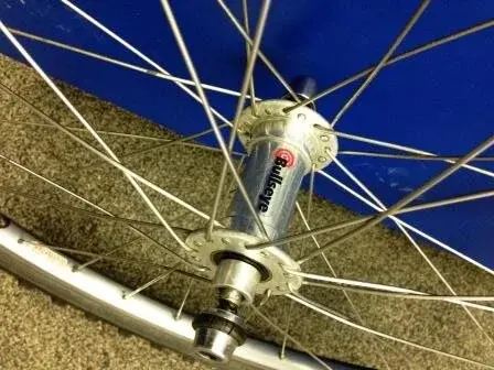

PostPosted: Sun Feb 24, 2013 1:34 pm
Joined: Fri Jan 14, 2011 6:06 pm
Posts: 24
Location: Birmingham, Uk
can someone tell me the size of the bolts on these hubs? They are not metric. I've got a pair of wheels with Bullseye hubs and want to replace the QRs with bolts.
