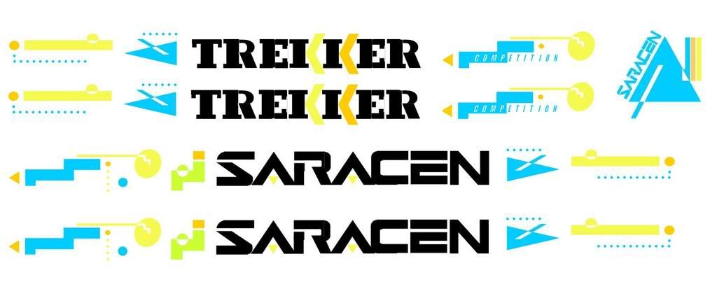

I was working on copying some trekker decals for Gil m to do at some point so I could get my trekker sprayed up green, :? I will have to see how far I got with em when I get back off me jollies :wink:
quite long decals if i remember right.

back now from me jollies and I had a look at the saracen decal design I had started might get em finished one day :roll:
actually - now I look at em, not completely happy with em yet so may start from scratch again :?

Retrobikeguy,
Those decals dont look half bad. Let me know when you have messed around with them as I said to Gil M I'd measure my decals and all that business, but if you've already done it it'd be a great help to me :D

Retrobikeguy,
Can I be cheeky and ask how those decals are coming along? No worries if you havent had a chance to look at them since.
I've just had the frame back from the sprayers and am itching to 'dress' it!
The ones attatched to this thread are good enough for me, what is the next step so I could get Gil to print up?
