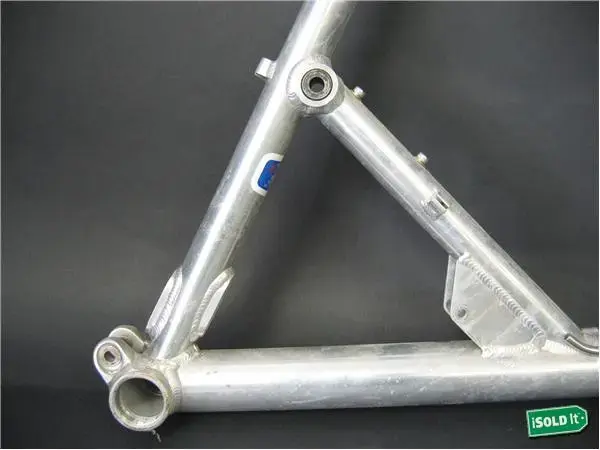

BETD still do the bearings , but for the rocker not the upper link/main pivot
link here , item = 608 2rs max (5th down) https://www.betd.co.uk/product_list.asp?CategoryID=155
mine doesn`t have any bearings in the main pivot , but it is an early one , it just clamps up against some bushings , as in the picture below
if its the rocker parts that have movement you can change them , if its the main pivot , maybe you could add some thin spacers ????

ah , now i see , so yours is different to mine
loooks like you could fit a sealed bearing if you got the right size
work a lot better too
all you woould need is the outer diameter of the frame pivot hole and the bolt diameter

http://cgi.ebay.com/NOS-GT-RTS-Rear-Roc ... dZViewItem
Any use...?
Neil
