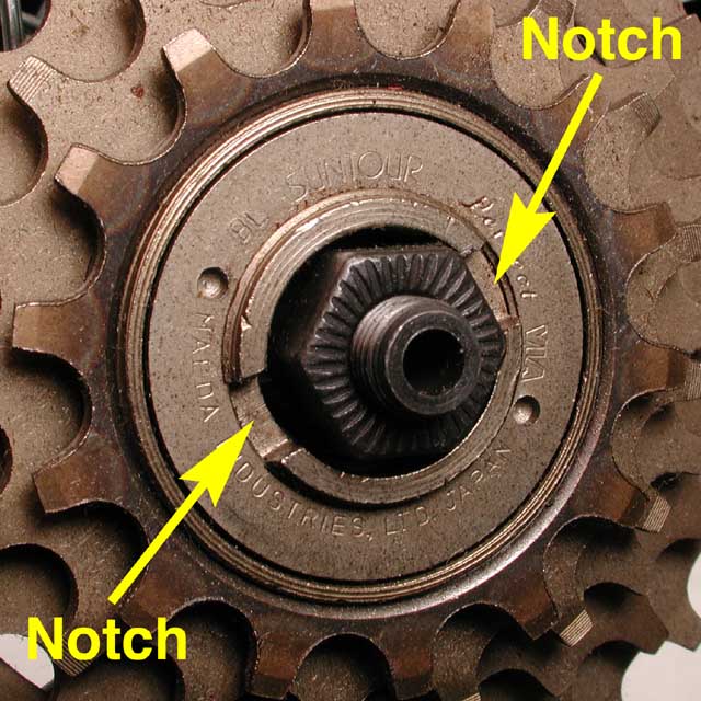

If it is an older type in might be a freewheel. In that case, look for notches as described in this page:
http://www.sheldonbrown.com/free-k7.html
If it is a freewheel, you will need a dedicated tool.

It looks like this, but the notches aren't there :?
I do not see something were a tool can be fitted.
The centersection does not rotate with the cassette.
I will take pics
