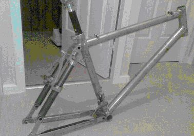

Kase1983 posted up a link in ‘Ebay and Marketplace Watch’ to an auction for a ‘very-rare-doug-bradbury-mountain-bike-race-frame’. It was a poorly listed auction with little in the way of text and even less in the way of photos, just a couple of badly lit cellphone photos of a dirty frame looking very sorry for it’s self.
Bradbury Manitou
The original cellphone picture
A few of us had a little bit of discussion as to what it was – ‘a Marin, maybe’? But having worked in a bike shop that sold Marin I knew it wasn’t (this one had gussets on the top and down tube), nor was it a Balance or even an Answer Manitou (rear forks were too old). So out of interest I shot a couple of questions off to the seller and got some promising answers, but then do you believe everything you get told by ebay sellers? He sent me some additional photos but, again, I really couldn’t see much from them. Even at this point the thought that this could be a Bradbury Manitou hadn’t crossed my mind, no body would be selling such a bike in such a poor way, surely? I just assumed that it was another no name frame being sold by someone keyword spamming. None the less I was intrigued but I convinced myself not to get my hopes up as with the word ‘Bradbury’ in the listing and its place in ‘Ebay and Marketplace Watch’ was surely enough to ensure the price would go through my ceiling bid. And when my lowly bid of £150 did actually secure I was then further convinced that I had just bought a cheap copy – surely no one would have let a genuine Bradbury Manitou go that cheap. But hey, I thought, for £150 what’s the worst that could happen?

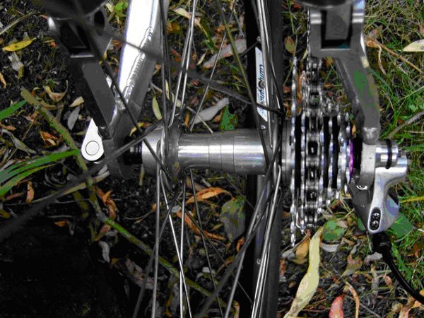

First the rear hub. I looked into many options such as Phil Wood or Shimano tandem hubs to fill the 145mm rear dropouts, but these were either incredibly expensive or just ‘not quite right’. Fortunately Karma was still smiling on me, as into my inbox popped an email from the original seller who had found the original rear wheel in his shed and he gladly passed it on to me for a few pennies.
As with everything on this bike this hub was quite special. The hub had started out life as a Shimano M900 before Mr Bradbury cut it in half and added in an extra CNC’ed section. This was an incredible stroke of luck as these hubs are as rare as the frames, Bradbury didn’t make these as an aftermarket product, they were solely sold with the frame as they were a part of his holistic view of bike building. The 145mm hub allowed Doug Bradbury to design the bike with an asymmetric rear end and a zero dished wheel – this creates a stronger, more evenly tensioned rear wheel with a single length of spoke on both sides. It also complimented the Bottom Bracket in creating better gear alignment.
Bradbury Manitou
Manitou rear detail

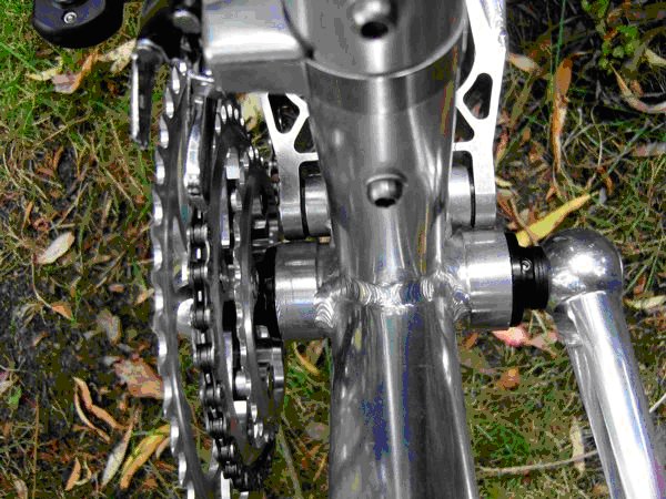

Next up I had to find that BB long enough to cope with a 90mm BB shell and a set of Cooks Cranks – one with at least a 140mm axle! Elite504 came to my rescue here with an axle designed to be used with super old Campag cranks on sealed bearing Bikes. So add this axle to a NOS cooks BB bearing and cupset that I just happened to have lying around and that was problem 2 sorted. The 90mm shell was a radical choice back in the 90s but is now a concept that has been adopted by more and more DH bikes as it offers more room for the rear suspension linkage as well as a stronger platform for your cranks but as with many great ideas Shimano and the like just wait until patents expire before they use technology rather than pay someone else royalties so that riders can benefit (Outboard bearings, hollow axles, 2 piece crank sets? Just think Magic Motorcycles, Sweetwings or Bullseye. Shadow rear mech – EGS thought of that first!)

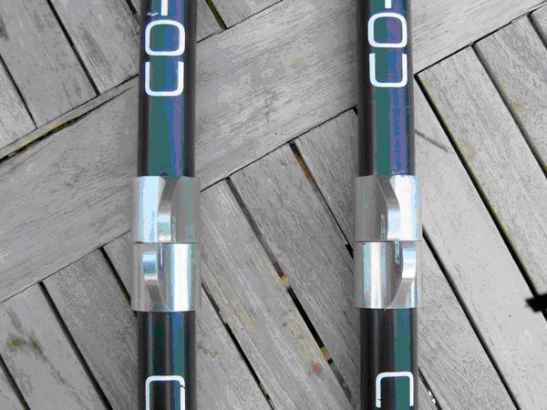

A set of over-long skewers was also provided by Elite504 in the form of a beautiful set of Ringle Cam Twists with custom cut rods. He also sorted me with a 100mm front Ringle hub to compliment the Trail stem, the H20 Cage and the Mojo brake hanger.

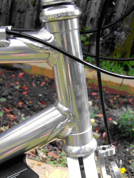

One last hurdle – I had to insert the headset! A tough job at the best of times but now add in the knowledge that Manitous are renowned for splitting quicker than a premiership footballer leaves his pregnant girlfriend. Would Karma leave me so near the end of this build and deny me the chance to fulfill this dream? Fortunately not – look Ma, no cracks:
Bradbury Manitou
Look Ma, No Cracks!
